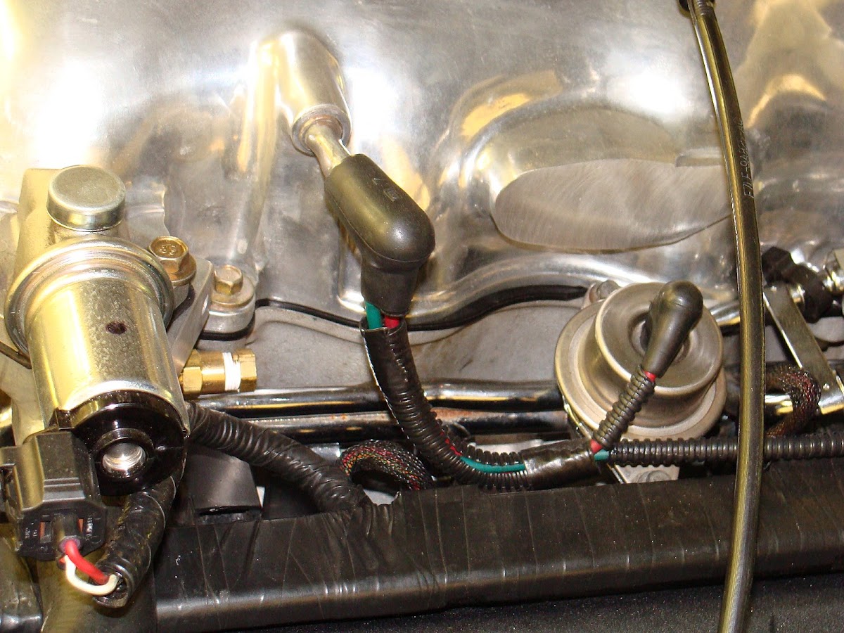

Also did a fuel pump. I am putting on a 96-98 cobra intake on my 97 and yes the 2nd gen rails will work IF you delete the EGR, otherwise it will block your testing port.
Just so you guys know, even if you delete the EGR, your fuel schrader valve for testing pressure will STILL be buried under the IAC valve and inaccessible.
I've found a couple cobra fuel rails on e bay im just t t ting to use all I can . it seems every time I tghink I've got it all I need something else. I couldn't talk mechanic into modifying throttle cable bracket so I've got to buy a 98 cable/bracket combo
