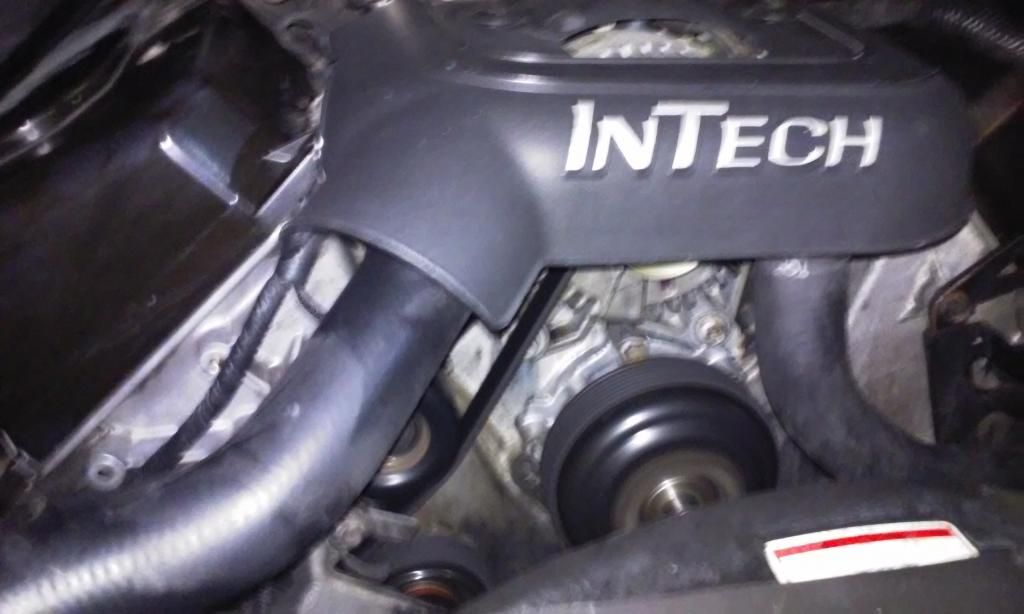

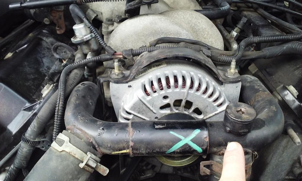

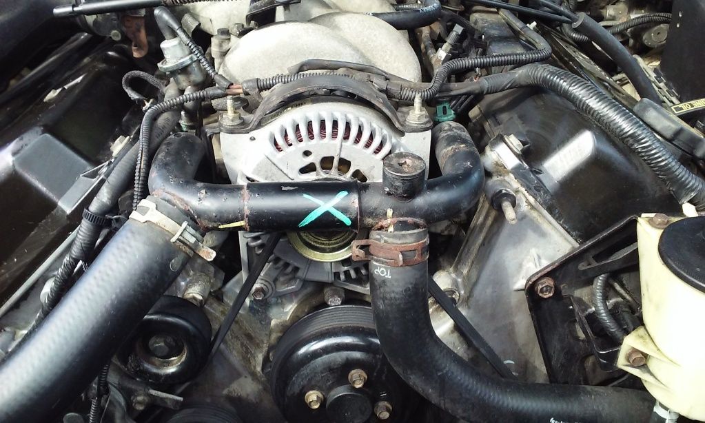

I had a small leak which turned out to be the water pump leaking from the bearing it's a usually a sign that it's going when you can hear the squeaking like it was making a week prior to going south. So I went and bought a new water pump for $40 Advance Auto new not remanufactured and a new oil filter and some oil while I'm here. Those of you who haven't done a water pump they're so easy in these Lincoln's you could talk a 10 year old girl through it. You want to loosen the nuts on the water pump pulley first before you lose tension in the belt it just makes it easier. Then loosen the belt unbolt the six bolts around the pump and it comes right out.
